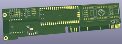

@David Cook, this is awesome. Have you successfully been able to transfer data serially, and if so, at what speed? I just recently made some similar PCBs, which are designed to have either an ESP8266, Raspberry Pi Pico, or generic "blue pill" board (choose one), which then attaches to the serial port. It's notched such that it can be used in either a CommSlot 1 or CommSlot 2-enabled Mac.

My board communicates at 57600 baud, no hardware handshaking. I have the pins for handshaking brought out to pad in case I want to experiment with them.
The TX pin on the slot is the Mac transmitting out. So, that should be wired to your microcontroller's RX pin.
And it follows that RX on the slot is the Mac receiving in. So, that should be wired to your microcontroller's TX pin.
By the way, there is a definite limit to the amount of power you can draw from 5V trickle. 5 ma I think. If you exceed that too much, the Mac shuts down almost immediately at power up.

Good to know, thanks, @David Cook . Can you share any information on voltage levels/logic types for the serial pins? TTL? CMOS?
It is non-inverted logic level serial (0 to 5 volts). I plugged it straight into an Atmel ATMega1284 microcontroller without any additional circuitry.
That is, it is definitely not -5/+5 or -12/+12 RS232/RS422 like at the mini-din modem port at the back of the computer.
Thanks, that's the assumption I was operating under, but it's nice to have it confirmed.
