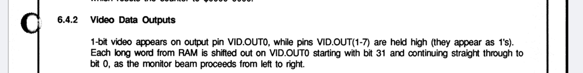

Well, @Arbee leaked the RBV datasheet (attached) which makes it clear, and it's very, very simple!
Lift a pin on the RBV and ground it, easy enough, and Bolle found that it'll even kindly output the special horizontal drive signal (SE.HSYNC) required by SE type analog boards. Grab TTL video from before the RAMDAC, and in theory you've got everything you need to drive the SE monitor: VSync, TTL Video, and the special Hsync.
Bolle wired this up and found that the SE video definitely works in hardware. The picture is exactly correct which means the syncs are sane, the pixel clock appears consistent (for uninitialized RAM). The board was upset due to lack of 5vSB, but it can clearly be seen the video is working. This now becomes a problem of software support.
