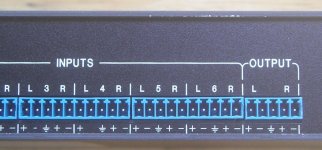

OK, I got carried away with the intro. ::)   So the original project/inspiration for the above had been relegated to IP tangent status. I have an Extron SW6 VGA Audio switchbox that has five lines available.
So of course I'm wondering about reduction of the switching circuits for audio to the least common denominator. Pulling ICs at one level or the other will probably be necessary to re-purpose one of the Audio ground lines as the +5V line of ADB.
I'm hoping it can be done at this level by pulling the INA137 AUDIO DIFFERENTIAL LINE RECEIVERS?
