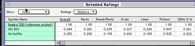

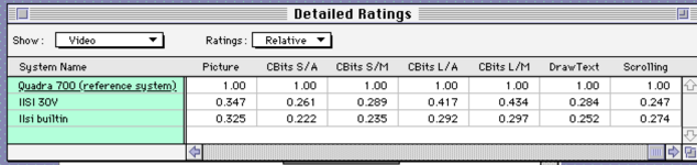

Performance vs builtin. Faster in all cases except for scrolling, not a huge increase, but it's there. Most are going to be limited by CPU rather than video performance, I think. Notably performance on large blits (Cbits L/*) is quite a bit better, which would benefit games which render a frame in RAM then transfer to framebuffer (marathon, doom, etc mostly). Unfortunately, most of those games are going to be CPU limited.
