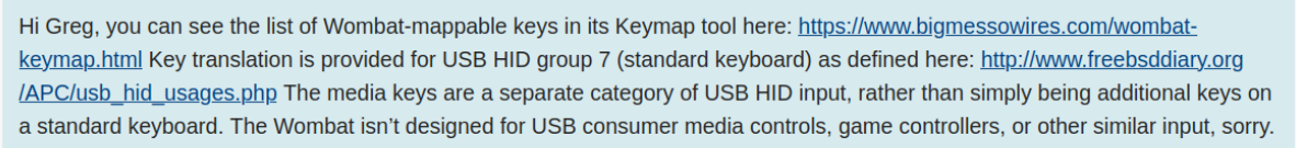

I’ve read the documentation - I understand that the wombat only works with keyboard and mice, and not with gamepad but…
If there are any USB gamepads without analogue sticks, which identify as keyboards (hence requiring no drivers, and hence only requiring configuration in the game itself), I can’t see any reason why they wouldn’t work. So…
Does such a thing exist?

did this ever get an answer? I believe the question was, "Can we use the USB Wombat to map a usb gamepad to ADB?"
If you wanted to make something, it would be fairly easy hardware wise. The arduino Leonardo and other Arduinos based on the ATMega32u4 and similar support spoofing a keyboard key presses.
pyranger
Active member
Yes, I have seen some arduino keyboard projects out there. As I already own the Wombat (just opened the box), I was hoping someone had used it for a gamepad and their experience could give me a head start. I'll tinker with it and report back my results.
