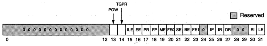

I plan to. I have an iBook G3 sitting next to me that runs NT in the wrong endianness (it boots, plenty of weird issues that would be HELL to debug), but thanks to the port to Gossamer-derivatives I learned what MSR_LE actually does, so eventually I'll do a bare metal ARC firmware little endian port to them (yes, I poked around uni-north registers hoping there was a PCI endianness switch register bit like on Bandit, but no luck).
Does the NT on PowerPC stay in little endian mode all the time, or does it switch to big endian sometimes? In either case, I am wondering if the LE check in dingusppc could be done outside the CPU instruction execution loop so that when it happens, the emulator just goes into a different CPU instruction execution loop.
It stays in little endian mode all the time.

OK, so based on the current conversation, NT for PPC could run on a 603e-based Mac as it too supports Little-endian mode, if it also supported built-in USB?
finkmac
NORTHERN TELECOM
to my knowledge, all powerpc cpus do little endian. the usb support for this isn't work yet either. neither of those are requirements for ntppc.
virtualpc even uses undocumented nanokernel calls to switch the cpu into little endian
