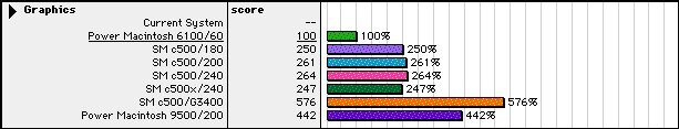

Some MacBench 4.0 test results. Pretty big jump in the processor test, ~40% improvement, it definitely felt faster with the CacheDoubler too. Quadruple the stock 256KB L2 cache memory (1MB) and running at 1/3 the CPU speed (80Mhz) instead of 1/6, the 40Mhz bus speed. …but of course a G3 blows it away, if only this tech was out sooner it might have been more common.
Note I named the results with CacheDoubler installed “c500x” as that’s what Umax did with the c600x which was the only model they shipped with one of these.
