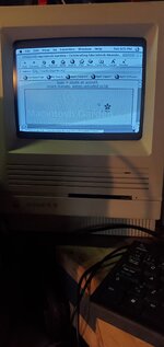

I've recently gotten my SE/30 up and running with Mac OS 8.1, and I have been trying to push it to the limit, on a budget!
Hoping for internet connectivity, I've been following a few tutorials around the web on how to network a Macintosh
using a USB/Serial adapter, an RPI and Slirp. I have had a heck of a time getting this working but I've managed to push 38400 baud through the modem port successfully and load some web pages.
Here's a tip for getting this working properly, I could not find this information on one page relating to old Macs so thought i would share it here.
