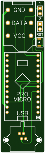

When it comes to a much smaller and slightly more cost-reduced version, here's what I call "the gumstick":
I sincerely try to avoid using SMD components, mostly to make sure anyone can assemble what I toss out there regardless of soldering skill, but this time I decided to make a slight compromise. The reset button is an SMD tact switch, but the pads are pretty decently sized and it has a stress-relief pin to keep it in place while soldering; so long as you put that on first, it should be doable for just about anyone. I tried to pick one that both met space constraints and looked easy enough to solder down, so hopefully that turns out okay. The whole PCB is about 75mm x 22mm (~3" x ~7/8") and is pretty much just an MCU, ports, and region jumpers. Approximate per-unit cost is about $2.00 less than the larger one, so it's not a huge savings, but it's super-compact - about as small as one of these can get. Here's the BOM from Mouser if anyone's interested in this ludicrously sized little gizmo, lol. I'm probably not ordering any of these right this second, as I prefer to try to consolidate JLCPCB orders into a single batch due to shipping costs; I should be placing one more order prior to baby showing up, so if anyone is interested, let me know!
