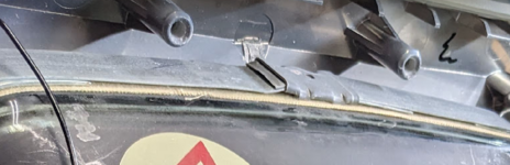

Juror22
I posted this in the lounge back in May (What did you do to your Mac today?)... the piece is still fine and although I haven't been removing that piece, I have taken the case off and put it back on several times since then and it is still holding without change. I think this fix depends on how good the original tab is. In this case (and on the IIvx) they were broken in about this spot which leave quite a bit to work with and adhere to, but maybe this gives you an idea on how to solve your problem.
"The from[front] panel that I sourced had a broken tab, as many of them do, so I had to fix it. I got the idea for the fix from one of the ways of repairing the Powerbook hinges that uses a 3D-printed plastic piece, glued onto the panel. Using a similar idea, I fashioned a plastic end piece for the tab with two pieces that would be glued onto the tab itself and use plastic epoxy within the piece for additional structural integrity.
It resulted in a fix that is solid, has some flexibility (like the original) but will not yield and maintains the correct lines from the outside. It had to look and function correctly and it does line up exactly the same as the original filler panel, which has a perfect tab. I will do a better job of documenting the next one (I have an original IIvx CD panel that needs the same fix and I think this will work for that just as well)."
