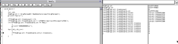

Problem: I can't seem to make internal assignments 'stick' for some reason. it has worked some times by stepping through with the debugger, sometimes stuff like theBigList.TrackEventList[j].trackno stays at 0 instead of taking values like 1,2,3,4,etc.

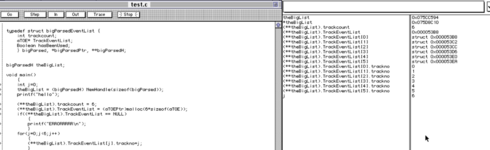

so maybe the solution is to use a handle so I can avoid my structs pointers to get trampled over?
seems to work here:

ok, the same example above, after running back in forth into my main project, rebooting my emulator, etc.
no.
longer.
works.
I bet it's something really easy I'm missing but I'm properly stumped.
this should output 0,1,2,3 in the first 4 trackno debugging values on the right since I'm at index j=4 here.

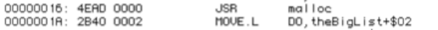

Add #include <stdlib.h> to bring in the correct prototype for malloc. Without that, the compiler assumes the return type is 2 bytes wide as show in the disassembly (Source -> Disassemble):
Note the MOVEA.W D0,A0 instruction which moves a word (16 bits/2 bytes) from D0, malloc's result register, to A0.
Here's the disassembly with stdlib.h:
Now the instruction is a MOVE.L D0,theBigList+$02, a long word move directly to theBigList's aTOE* member.

thanks all, it seems to work taking 0 chances with:
-using a MaxApplZone() at the start
-using MoreMasters() for good measure (who knows how some .midi files go up in size and data content)
-NewPtr and DisposePtr for those arrays in case a 2nd, 3rd, etc file is loaded up (so I'm currently moving away from malloc)
-HLock and HUnlock for the handle, although that turns out to be pretty small* and could be transformed into a Ptr itself.
*it's only gonna carry a few atomic members and an array of pointers to the other levels of my overall structure. in the worst case, about 20-30 pointers to add on top of that.
