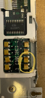

Recapped a powerbook 100. She turns on, and gives me the black screen. Once in awhile she will give some lines, or an actual screen of some sort. Something smelled hot, so I noticed a little sparking on the the caps on back of display. I took the ones I thought were doing it and re did them, but one still seems to so it. Cap isnt exploding, just some spark. Any ideas?

3lectr1cPPC
my uneducated guess is that something is shorted to ground, probably a cap connection (caused by cap juice?)
also check the inductors on the logic board, they're susceptible to corrosion and their purpose is to drive the LCD voltages so if they're bad then the LCD won't work. My guess is that it's more than that due to the sparking though.
Byrd
I'd replace the sparking cap, and check continuity and further deep cleaning of the site at the same time.
