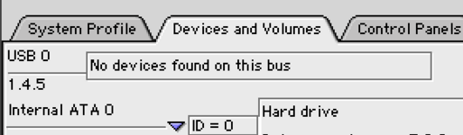

Powerbase
NEC chipset I've heard are fairly well supported under classic Mac OS. Is there a USB field at the top of the system profiler page on 'Devices and Volumes' that says like USB 0 or something?

nathall
Nope.
