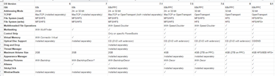

As a side note, I've been trying to put together a chart showing what each version gets you. I couldn't find one myself so I threw this together. If other people would like to help review/add to this I can make a new thread for it. Note that this screenshot may be incorrect since it's just from my own quick research.

Oh hey, neat! I'll add that to my chart lol
Although seeing that it doesn't work with Multifinder is kind of a bummer.
I have actually almost never use multifinder, I tend to use 7.1 if I'm looking for that sort of thing since... we'll, it's like multifinder but better 🤣
