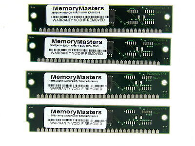

I'm not sure the chips for 8MB or 16MB SIMMs are documented anywhere but I have seen posts where folks have made them using the same boards. The ebay seller I got my SIMMs from is https://www.ebay.com/str/memorymasters
They were super helpful. I messaged them with the link to the github for the project and found me some SIMMs with the TI TMS417400ADJ chips. Here is what I got: https://www.ebay.com/itm/163059887271
I did just order this SIMM to test making 8MB SIMMs but havent recieved it yet.
I can let you know what chips are on it when I get it and if it works after I build the new SIMMs.
