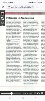

I do indeed have both the CDR and the floppy disk, and the floppy disk includes drivers for the HyperCharger, but they're identical to the ones found here:
I did not receive a manual or any documentation with this one either, but I saw that someone was looking for one as well in this old thread:
