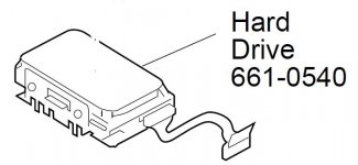

I was thinking along the lines of using my DOA HDD as the chassis with a clear vacuumformed replacement lid.
But a printable adaptation of the HDD form factor might make fitment of the various bits a lot easier and be useful on its own as a campy PiBox?

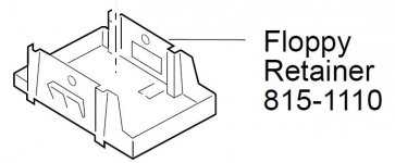

Extra points awarded for designing either that printable HDD like chassis making use of the HDD's carrier or a printable ABS mimic of the Floppy Retainer (looks like the original is stamped metal?) and some ponoco'd clear plexi bits instead of doing the HDD lookin' thing.
