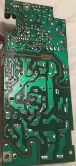

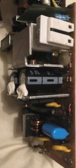

Ok attempting to upload some images....
If anyone can spot anything or has any recommendations, I'd appreciate it. Have never repaired a PSU before. But it is discharged I believe... in that it hasn't been connected to power for at least a year.
@hackdog @techknight @GeoffreyReed
Thanks in advance!

Fuse F101 appears to be missing, but there are end caps in the fuse holder?? Was there ever a capacitor installed at C116? It's not obvious from the picture if something was there previously. Maybe C302 is leaky?
kiiwii
Yeah there was a fuse, when it blew that’s all that was left... not sure about C116, I can check my other PSU it’s the same model. I’ll check C302.
Thanks for your tips @cruff
Edit: just checked C116, nothing meant to be there. Checked both PSUs. Well spotted though!
