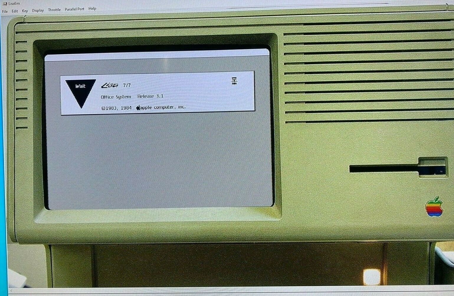

1.2.7 RC4 works for me on macOS (M1, using the arm64 build.)
There were some hiccups:
1. I found that I definitely needed a boot ROM file. Without it, attempting to boot from the floppy image would give me this error: "cpu68k_makeipclist: But! ipc is null!" Eventually I found a thread at https://www.applefritter.com/node/20185 which was helpful in getting past this point and successfully booting the emulator to start the installation of LOS.
2. I had already created a ProFile image without the ROM file specified. That made it unusable for some reason. Trying to install LOS appeared to work, but then booting up into the ProFile drive afterward always failed with error "Doh odd PC value (ffffffff) on vector (3) fetch in reg68k_internal_vector - BYE BYE" and would exit the emulator. After creating a new ProFile and reinstalling, I was in business.
