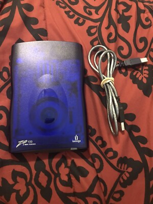

cheesestraws, well this one;
has no logo which was why I had wanted to recheck that it wasn't just me as I think that officially it was only usb or usb/parallel and web people just are confused indeed :-s (and like bibilit said re somewhere to set the scsi id as well)
Pretty certain that connector, which looks a bit like SCSI 2, is actually used for firewire and PCMCIA adaptors - this could certainly lead to some confusion.
edit: like this
Also the first external "ice blue" Zip 100 drives had what I beleive was an IDE interface visible (but unpopulated) inside the case

@aladds is correct: I have had one of these drives since it was new, and that extra SCSI-like port is to connect the FireWire adapter on the back. I have one.

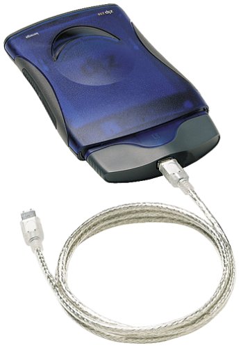

Here is a good online photo of the drive with the FW adapter attached:
