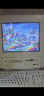

I recently came across this Power Mac 5300 on FB marketplace. It's a decent all-in-one, but I wasn't planning on picking it up until I saw the back of it. Seems to have all the bells and whistles. I'm looking forward to playing around with this and seeing how well the capture works.279041628_5246731952052475_1098217279706074823_n.jpeg279425885_5108792955902771_2426081831885285636_n.jpeg

Beautiful!, very nice find. Enjoy your playtime with it. VidCap at the consumer level was pretty neat back in the Quadra 630 day and remained so into the PPC generation. Is that the Presentation System video out port I spy?
I used one as my TV for a while when I was turning the kitchen corner of my sign shop into an Artist In Residence space. Keep your eyes peeled for the MPEG Media System for more fun in the future along with a CS(1) NIC, at that point you'll have about everything fun you can possibly fit into that drawer.

That looks like a fun machine! Looks like the video capture card, the TV tuner, and the presentation system port, which created a mirror of the built-in display for use with a projector, since these were option used in education.
This is often already known, but just in case: The talking points about the 5200/6200 aren't true and these perform "fine", if a little slow in accordance to the fact that they were consumer machines. The 5300/6300 have updated CPUs (and, critically, more L1 cache) and are reasonably faster than the 5200/6200. The PowerBook 1400/2300/5300 which also use this architecture typically have the upgraded L1 cache, although not all of the PowerBooks have any L2 cache, and all 5200/6200/5300/6300 have 256k L2 cache. (6360/6400 and 4400/6500, that cache was optional, but L2 became standard in the L3 and the main differentiator was "how much" with consumer Macs having 256-512k and pro Macs having 512k-1M.)
Curious to see how well the capture works. It should work great as pass-through but even higher end Macs from this and slightly later eras aren't really "good" at capturing video, the way midrange software tended to do it was to use serial controlled VCRs and capture until a frame dropped, then stop, rewind, and continue from that point. (DV software does this too, with firewire devices.) You can turn down the size and frame rate or just do smaller segments by hand, as well.

Thank you for the welcome and for the info!
I am excited to try this (I'm wanting to try to use it as a monitor for a C64), but I have a backlog of other machines that I need to get to. :(
Wasn't great, but at the consumer level nothing was where it existed at all. Tons of fun to play with. Worked a treat using Timbuktu Remote to take clips to confirm visually that my my plotte and its job server at the shop had or had not yet finished a long run. If the vinyl was still on track in the VidCap/test routine I took from home I could then start up the next job. Fabulous even over dialup.
Apple really missed the boat by not implementing a rudimentary video conferencing setup on the 630 drawer based consumer class machines in that time frame. All the parts were right there but the VidCam, later WebCam as things moved in that direction.
