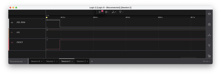

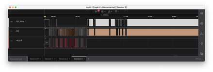

Some progress today. I'm out of time and will continue tomorrow. /AS, 68030 address strobe, had a bad trace from the 68030 to the nearby via, near C13. This trace looked fine to the eye, but the eye of the via was dark dark corrosion-green. The solder mask over the trace was shiny and smooth. The 030 lead had a solid conductive joint with its pad. But placing the wire changed the behavior in a good way; GLU now has some idea what is happening.
Still no chime, but, it's progress. The leaky old C13 that I replaced may have damaged more traces in that area. Now I know where to focus my efforts.

A scope trace showing no activity on /AS before the rework:Screenshot 2025-05-27 at 13.28.38.png
The same trace, resampled after the rework. Unclear to me why /RESET is bouncing. I added a momentary button for S1 (the unpopulated reset to Egret) and that is me releasing the button. There's a small cap around it that should keep this from happening. Or, I didn't check -- maybe that cap is also unstuffed.
