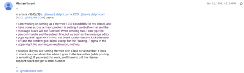

Looks like the issue goes wayyyy back to the beforetimes! I've seen conversations about clocks being configured wrong, etc, causing the issue.

Interesting, so the crack really didn't work. I'll let Sidd know.
Thanks much. It's not so much that it didn't work it seems - it did exactly what it was supposed to do - it allowed the use of the old serial #. However, somewhere in the code of the program it's supposed to do something odd when it comes across that serial #.
