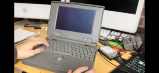

It has arrived! And it made it in one piece. It was packed with tons of bubble wrap (although somewhat insecurely), but all parts arrived in great shape. The seller also packed the trackball separately as I requested.
I plugged in the PowerBook and it immediately started up to the blue/black screen of death as expected. It can be caused by 3 faults:
1. The contrast is just turned all the way down
2. Bad capacitors on the LCD panel
3. Backlight is receiving power and turning on, but the LCD is not initialized and is not receiving signal.
It's very likely to be a combination of 2 and 3 behind my issue.
There's a small dark spot where the trackball would be, but no pink spot damage, and it shouldn't be noticeable when the LCD is actually displaying an image. You can see it in the picture, but it's minor.
