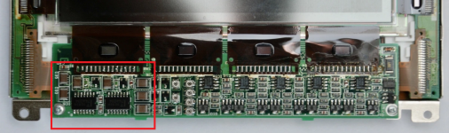

Here a pic of the driver board I still had on my phone:

One last question:
There's these capacitors here that I've "circled" in red. Are these something I need to replace as well? I'm worried about them because they're running right next to the delicate ribbon cables
ian1035nr
Just realized that those look nothing like rectangular, surface mount, electrolytic capacitors. And whoever had a 180c with gap goo in the cables likely had the laptop stored on its side, letting gravity slowly pull expelled electrolyte from the other side of the board into the cables. The fact that it took me so long to realize that is sad. I knew I was dumb/out of it, but I didn't realize the situation was this dire.
That makes my life easier, just going to grab the appropriate caps and get this thing fixed. I just found a Reddit post of someone with exactly the same same problem as my unit, someone in the comments apparently had the same issue and fixed it by replacing the electrolytic caps on the back of the board, so I'm hopeful.

Sutekh, you are an absolute legend. Thank you so much!
One last question:
I would also pay some attention to the right side of the board (in this image) - there's some residue / crustiness on the plastic and connections of the driver that may partly at fault (if the symptoms are appearing near there). A word of warning though: Clean lightly and gently. I have a passive matrix display that exhibits some 'banding' that is clearly caused by a compromised connection inside the plastic of its column driver. The silly thing is that I actually caused the issue because I was so focused on getting rid of electrolyte residue inside that driver, the IPA dissolved much of whatever adhesive is under that plastic. Ignorance is bliss until it isn't.
A light surface cleaning might be enough to deal with what's there.
ian1035nr
That picture isn't actually mine, I pulled it from this website:
https://oldcrap.org/2020/04/27/apple-macintosh-powerbook-180c/
I was at work at the time and didn't want to wait until I got home to snap a photo of my own LCD. My board is nice and clean there. Actually, the underside with the bad caps was pretty clean, too. Just a very small amount of residue around the cluster of caps. Which is probably why the screen still works as well as it does. The banding is annoying but there's no dead pixels or anything of the like.
