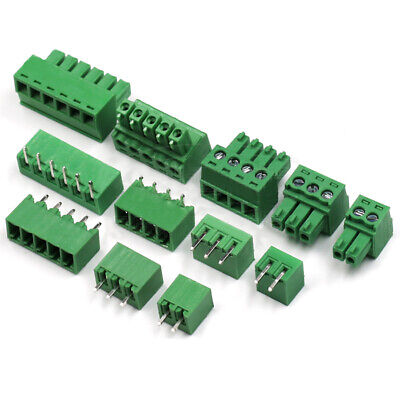

Anyone in the UK looking for the power connector, I think (not arrived yet) this is the right part :
10 for £3.94. Make sure you select "Hole Plug" (?!).

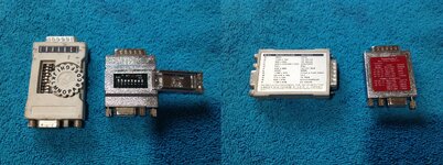

Video adapters I used. The one on the left, with the Radius-type font "ENHANCE" was something I couldn't get working on any setting. Perhaps I should call an expert, @Trash80toHP_Mini. The one on the right, Viewsonic adapter, worked with 1258 DIP settings.

When I first got the scalar hooked up and booted the IIsi it wouldn't work. That's when I found out that if you hot-plug in the video adapter it wouldn't work: instead I'd have to power cycle the machine, and it seemed to only work if the adapter was plugged into the machine with the power off first.
Don't hot plug ports on old computers, they're not designed for it! The Ground pins don't make contact first and the ports often don't have that much protection.
