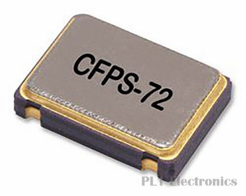

I'm trying to work out what oscillator to use, I know for certain it's a 48Mhz part and probably 5V at that. Not sure what SMD package type would fit since the plastic ones don't seem to be made anymore, and the ceramic ones I've been perusing on Mouser are bloody tiny.

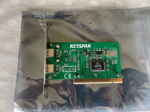

Is an oscillator even needed at all? In @zefrenchtoon 's picture of the Yikes! motherboard, there's just an empty pad where that would go; equally, some PCI USB cards have the oscillator while others omit it. I read that the USB chip can generate its own internal clock but it's less reliable than an external crystal.

I have a new multimeter that can test capacitance, and have been examining the SMD caps on my Belkin donor card. The ones by the USB ports measure 0.5nf whereas most of the others on the card are 100nf. However there are some pink ones that don’t seem to have any capacitance at all, nor continuity. Is there such a thing as dummy capacitors?
