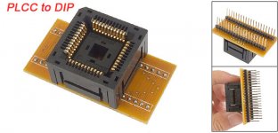

See that adapter? Think about it as a little bit of inspiration.

First problem:  form factor. The IWM and SWIM chip in the Macintosh SE is the 28 pin DIP package. Yeah, good enough. Too bad that the SE/30 SWIM form factor comes in a 44-pin PLCC form factor. (square package with pins on all sides vs. rectangle package with pins only length-wise)
So, looking a little deeper at the documentation referenced below, it seems they are work-alikes, they just need to be wired up properly.
And possibly it may mean that I need to do a bit of board design to get the right pinouts. This is new territory for me, but nothing's impossible, right?
So then the living Mac SE gets the SWIM chip in the bespoke cradle in a DIP package, the SuperDrive from the donated SE/30, and a whole new era of parts salvage possibilities comes about. This feels easier than, say, trying to emulate the behavior of a SWIM chip in a programmable package (using a Teensy or similar that's more powerful than the Mac SE itself.. ha!)
Assuming the board pinouts were routed appropriately and the thing actually works, I'd imagine this would be useful for people doing resto-mods and retro-upgrades to their Macintosh SE machines.  Donor boards for SWIM chips wouldn't be limited to just SE/30's, they could come from Classic logic boards, IIci boards, etc.

Whoa, well done!  Was thinking "hey! My work is done!" but I think you were going the other way around and also using the smaller form factor PLCC pinout rather than the SE/30 44-pin PLCC to the SE 28 pinster.
Thanks for confirming my theory of swap-eration!
