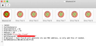

I have a real Dayna SCSILINK and it works well with my IIsi and System 7.1 ...
When I use a BlueSCSI the Harddisk part works fine but the Network do not work.
.... where could the problem be and who can help ?
log ->
Platform: BlueSCSI
FW Version: 2024.05.21-rel May 21 2024 21:21:44
I2C Supported
Flash chip size: 2048 kB
=== SD Card Info ===
SD card detected, FAT32 volume size: 3773 MB
SD Name: SU04G, MID: 0x03, OID: 0x53 0x44
[175ms]
[175ms] === Global Config ===
[176ms] Reading configuration from bluescsi.ini
[176ms] Active configuration (using system preset "Generic"):
[177ms] -- Debug is enabled
[177ms] DBG -- Parity is enabled
[177ms] DBG -- ReinsertCDOnInquiry is disabled
[225ms]
[225ms] === Finding images in / ===
[226ms] == Opening /NE5.hda for ID: 5 LUN: 0
[226ms] ---- Configuring as network based on image name
[226ms] DBG ---- Read prefetch enabled: 8192 bytes
[227ms] ---- Image ready
[227ms] == Opening /HD1.hda for ID: 1 LUN: 0
[451ms] DBG ---- Read prefetch enabled: 8192 bytes
[451ms] ---- Image ready
[452ms]
[452ms] === ROM Drive ===
[452ms] Platform supports ROM drive up to 1692 kB
[452ms] ---- ROM drive image not detected
[452ms]
[452ms] === Configured SCSI Devices ===
[453ms] * ID: 1, BlockSize: 512, Type: Fixed, Quirks: None, Size: 1855500kB
[453ms] * ID: 5, Type: Network, Quirks: None
[1260ms]
[1260ms] === Network Initialization ===
[1261ms] Unique board id: e6 61 30 10 0f 1b 7a 22
[2174ms] Wi-Fi MAC: 00:80:19:10:0F:1B
[2174ms] Connecting to Wi-Fi SSID "Fritz!Box Frank" with WPA/WPA2 PSK

franklyn
The problem is sitting in front of the screen ...
I had entered the SSID in lowercase instead of uppercase !!!
