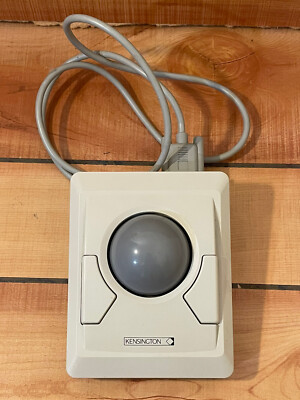

Is this one?
Is this one?
I just DMed you about that one :) I think so, yes - the seller has the cable the wrong way around, the mini-DIN goes into the back of the trackball and the D-type goes into the back of the Mac. The D-type on the trackball is for a passthrough mouse.
That said, it's possible that that one is a mislabelled serial one, since we can't see what the plug is, and I don't know whether that's the right model number. But the odds are fairly good...
