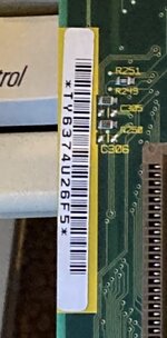

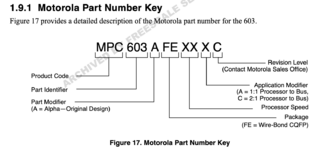

I have the same board, but mine is water and bad recap job damaged beyond repair, so I removed the heat sink to have a look at the processor:
According to the part number, I that's a 100 MHz CPU. Some differences between IBM and Motorola numbering systems though.

Please please please believe me, the PCB date code is too new to be a 75MHz 6200. I don't understand why you won't believe me.
6 37 - that's more than half way through 1996. Compare it to the sticker on the back of your 6200 - the date on the case serial number won't match because the board is not original to the machine!
It doesn't really make much difference and I don't know why your bus is reported as 37.5MHz, but I promise that nobody has switched the CPU.
