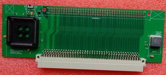

Here's what the 32 MHz board looks like:
Clearly it's missing an important connector :) I don't have a PDS card to test it with, so I haven't soldered the second DIN connector for now.

Why the unnecessarily long clock trace from the oscillator over to the FPU?
I have found that a lot of newer 5V oscillator cans have really weak outputs. Move the FPU socket out of the way a bit and put the oscillator right next to it for minimum clock trace lengths.
Putting termination resistors towards VCC and GND at the end of the clock trace can help too.
The extra oscillator was kind of an afterthought; in one iteration it was much closer (above FPU, left of the manual switch), but finding available 5V oscillators in the appropriate footprint was a challenge. So I moved it to where I had some room left for a larger, more available, easier-to-hand-solder footprint... The trace is long, but it's still shorter overall than from wherever the motherboard oscillator is ;-) But yes, it's far from ideal.
(shine a light in the IIsi gut...)
Oooh, there's quite a bit of clutter on the motherboard on the FPU side. I just noticed the FPU socket barely clears the power connector for the hard drive! There's some height restriction in the area missing from DCDMF3... So I can't move it lower - higher is possible. The oscillator could go below the FPU in the bottom right corner, even DIP-14 should fit between the height restricted zone on the left and where the HD power connector lives. Or I could just go for DIP-8 only.
Should have done that in the first place... but I got a bit lazy and didn't want to reroute all the data signals to fit the oscillator closer when I switched to DIP-8 :-/
Mmmm, when you say 'end of the clock trace' you mean near the input of the silicon switch, not near the oscillator itself, I assume? How would I calculate the resistor values? (I'm not a hardware guy, the analog/signal integrity part is still mostly a mystery to me...). That would be only for the 'long' trace, if I were to move the oscillator closer the pull-up/down would not be necessary ? (wouldn't that just create a voltage divider?)

Bolle
This.
330/220 towards VCC/GND seems to be what's commonly used. I'm not the "calculate stuff" kind of guy either, I just use what I have seen on other designs and only mess with it if it doesn't work the way I did it.
I have seen 100/100 as well as anything in between. So I'd stay stay in the 100-1k range and you're good.

What does your 5V rail measure at the FPU? The FPU may not run at its rated speed with a weak supply.

Melkhior
I agree that moving the oscillator closer to the FPU is a good thing.
If I move it below the FPU (where there is enough space for DIP-8), it still has to talk to the switch above the FPU - somewhere below 40mm of trace (current is slightly above 113mm).
The FPU input pin is near the top left corner of the FPU. I can move the (silicon) switch nearer to it (more to the left), it won't change the length of the CPU clock trace much, just move the length from after to before the switch.
The FPU power pins are hard to reach, but at the (unsoldered) top connector (2nd and 4th row from left, it's a +5V power plane on the second internal layer), it's easy to reach.
My voltmeter says only 4.885V when running the chip at 25 MHz. It's within 5% of nominal (5V-2.3%), no idea if it would be enough for higher frequency... I could measure with the 33 MHz board, but that would require me to move the PLCC FPU back - removing it from the PLCC always feels risky, those sockets are flimsy!

Melkhior
I knew I had a known-good PGA 40 MHz 68882 stashed somewhere, as 20-odd years ago I tried it in one my Sun 3/80 motherboard - those have a jumper to run the '882 at twice the system clock speed, 40 MHz instead of 20 MHz. Turns out the fast '882 was still on the motherboard, with the original 20 MHz one stored nearby :)
So now that I could take that variable out of the equation:
PGA socket instead of PLCC, and the oscillator moved from the right to under the '882. Other than that, same principle.
Works fine at 20 & 40 MHz in my IIsi. Performance improvement is measurable at 40 MHz, but not anywhere near x2 - IIRC, I had made the same observation running PovRay on the 3/80 back in the day. I guess a lot of time is spent doing bus transaction between the '030 and '882.
I probably should solder another one to put a '881 in, and finally do some '881 vs '882 measurement :) But those 188 solder points (plus 4 for the clock if installed) are a chore :-( I probably should do another PLCC as well with a 32 MHz clock to double-check if it's not the specific board itself that prevent the PLCC version to run at 32 MHz.
For those interested, both variants are on the GitHub.
