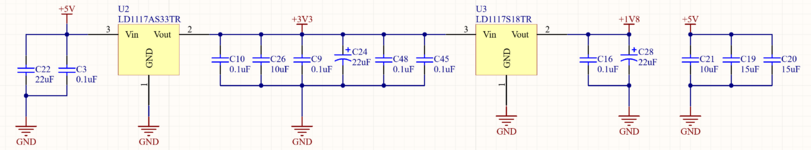

May already be accounted for, but has any consideration been given to the issue with the regulators where you end up having to bodge a Micrel 29150 onto the chinese cards to make them work with certain systems.
Seems worth investigating if going to the trouble of making a new card, surely there are other solutions besides that exact regulator but anyhow.
aperezbios
This is part of why we chose to _not_ use the generic Chinese cards as a starting point, even though it would have been easier, and less costly, to do. Those designs are just too cost-reduced, in our view. Here's the relevant section of the schematic from the reverse-engineered Adaptec ASH-1205SA power regulation circuitry.1673628105986.png
From the referenced thread/e-mail:
As a recommendation and alternatives:
1. A typical LDO will turn on at 1V. The 5V to 3.3V Micrel regulator will turn on quicker than the LDO from AMC. This allows the 1.8V control logic to be one before the 3.3 on the PCI bus. Using the Micrel regulator could gurantee current power sequencing operation.
2. Two 5V regulators can be used. One that supplies 5V to 3.3V and another than supplies 5V to 1.8V. The same type of regulator should be used to maintain the speed, but typically the 1.8V will be on before the 3.3V."
This design already employs recommendation number two, so we should be good. If we end up needing to make BOM changes in the future, it's really not a big issue.

This is part of why we chose to _not_ use the generic Chinese cards as a starting point, even though it would have been easier, and less costly, to do. Those designs are just too cost-reduced, in our view. Here's the relevant section of the schematic from the reverse-engineered Adaptec ASH-1205SA power regulation circuitry.View attachment 51175
Sweet! I'm super excited to see this come to reality! Don't mean to overstep I think we are all just excited about the possibilities.
