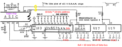

DRAM is like a bathroom tile floor or a piece of graph paper. It has rows and columns. Each time a memory chip is accessed, it is given a row address and then a column address to finally look up the data. For example, "please look up the data at row 5 column 2". To save on pins, the same pins are used for both the row and column address, but at different times. Another two pins signal the times when to look up the row address (RAS) and when to look up the column address (CAS). For example, address_pins=5, RAS, address_pins=2, CAS, is like me saying "Look up 5th row" (you move your finger to that row) and then I say "2nd column" (you move your finger across the row until you find column 2 and then tell me what you see).
So, in the diagram above, the Eagle chip can lookup 2^12=4096 different rows followed by 2^12=4096 different columns. That's 4096*4096=16,777,216 different total memory cells. 16 million!
Looking at the Bomarc schematic, we see that onboard DRAM is only given 10 address lines (RA0 to RA9). That's 2^10 * 2^10 = 1,048,576 only 1 million cell locations. Fortunately, there are 4 memory chips (U13, U14, U17, U19) being accessed in parallel, so that's 4,194,304 million cell locations. But, oh no, each memory chip can only output half a byte (4-bits, 1 nibble), so that's 4,194,304 million cells / 2 cells per byte = 2,097,152 = 2 MB of RAM. That's exactly what the Classic II has onboard.
Fortunately, on the LC II, they use 8 memory chips (U12-U19) to have 4 MB of RAM. They added two more column select pins to access the additional memory.
If you wanted 4 MB of onboard RAM on the Classic II, you could cut pins 83 and 119 (see above) and feed them into a daughter board that would connect them to the original set of chips when RA10 (the next highest address bit) was low and connect them to a new set of four chips when RA10 was high. Of course, you'll also need to feed all the added chip pins (address, data, power, R/W, etc) from the existing onboard memory to the new daughterboard memory. That's a lot of cutting and soldering.

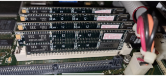

SIMM Slots

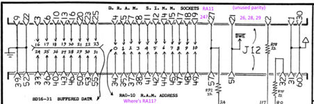

Standard 30-pin SIMMs have 12 address lines (RA0-RA11) and 8 data lines (not counting parity which is unused on this Mac). Remember, these are DRAM address lines not CPU address lines. So, that's 2^12 * 2^12 = 16,777,216 worth of 8-bit data cells. 16 MB! Fantastic? Sadly, no. The Eagle chip does not connect to SIMM socket pin 24 (RA11). So, that's only 2^11 * 2^11 = 4,194,304. 4 MB! Oh, that's exactly the maximum memory SIMM that the Classic II accepts per slot. That's 8 MB total for the pair.
Why Do You Have to Install a Matching Pair of SIMMs?
The Eagle chip addresses both SIMM slots at the same time, using 8 bits from one slot and 8 bits from the other slot to fill its 16-bit data bus. That's why both slots need to be filled and they both need to be the same size SIMMs. If one SIMM was missing, half the bits would be missing on each read. If one SIMM was larger, the smaller SIMM would either repeat bits from earlier in memory (wrong bits) or again be missing half the bits.
Let's say you cram the next biggest size of SIMMs into those slots. 8 MB 30-pin SIMMs don't exist. It goes 4MB->16 MB. Now you've got a pair of 16 MB SIMMs for a total of 32 MB of memory. Because the Eagle chip only has 11 of 12 address pins connected, each 16 MB SIMM will be seen as 4 MB with the extra never being accessed because those higher row/column addresses are never hit. You're back to having a pair of 4 MB SIMMs (8 MB total) as far as the Eagle chip is concerned.
The Classic II schematic is missing descriptions for pins 89 and 103 of the Eagle chip. I haven't checked all the pins, so some pins might not be listed at all. There is a possibility that an undocumented pin on the Eagle chip is the desired missing 12th address pin (RA11). Cutting whatever trace (likely ground?) connects to SIMM socket pin 24 and hooking it up to the undocumented RA11 Eagle chip pin would then theoretically support 16 MB SIMMs.
Even in the unlikely event that Eagle has an undocumented RA11 pin out, it would also need to be designed to service this additional memory during refresh cycles. Let's assume it does that.
