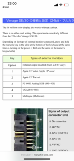

I found this, seems you hold down a number on the keyboard according to this table upon boot to change card settings. This table only refers to the ”non cad” version of the card, so perhaps simply try numbers above 5 if the multisync setting doesn’t give you extra resolutions in the monitor control panel.

Nice find. This was useful for me as I found the Option key to disable works on GrandVimage too.
The Supermac I used to have had a nifty feature where you hold down the spacebar, then it cycles through different resolutions and timings. Once you get a clear picture, you just let go of the spacebar and it boots with those settings. Pretty darn useful.

The trick is holding the number key/letter key down at power-on AND not having these keystrokes intercepted by the SIMM driver.
