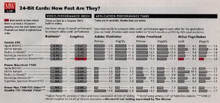

Some tests from Macworld Oct 1994.
As in our last video-card roundup, we found that accelerated video handily outpaces the 68040's unaccelerated on-board video but that the subjective difference
between one accelerated card and another that costs twice as much is only slight. In using the cards over a period of several months, for example, I was dissatisfied with the pace of only two cards, the $699 Mirror Tornado and the $1999 RasterOps Horizon 24. The other cards performed so similarly I could hardly tell them apart.
The Power Mac Factor
No matter how much emphasis you place on the occasional speed differences between the five cards, the equally fast performance of the PDS cards included with
Apple's Power Mac 7100 and 8100 calls the entire category of accelerated graphics cards into question.
Don't expect an accelerated video card to turn your graphics applications into speed demons. Upgrading from a Quadra to a Power Mac, for example, will have a greater impact on the speed of native applications such as PageMaker and Adobe Photoshop than will adding on a new graphics card.
Meanwhile, Macworld Lab found that the PDS card actually performed faster than any thirdparty card tested when using native Power Mac graphics programs such as Aldus FreeHand 4.0 and Adobe Illustrator 5.5. (Previous Macworld Lab results show that the PDS video was slower when using prerelease native software.)
Of the five cards tested, the SuperMac Spectrum Power• 1152 gets the highest recommendation, thanks to its relatively modest price and its quick performance (the fastest of the five cards tested). Certainly, the LeMansGT is every bit as good as the SuperMac card, and I even prefer many aspects of its software. But its high price makes it more attractive to graphics professionals who need sophisticated calibration options, and these options won't be available until Radius ships new software for its PrecisionColor Cal ibrator sometime in late September.-
