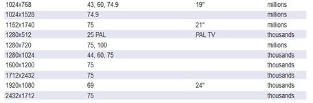

Sonata Pro 24 does 720p in 24bit and 1080p in 16bit! That is one hella NuBus card right there. Strange that it doesn't do 1152x870, but 1152x1740 and 1712xx2432 are some kinda crazy Portrait resolutions! If it did 1920x1200 I'd DESPERATELY NEED one!

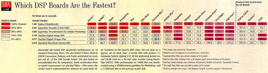

Interesting that these cards no longer have need of the DSP arrays on pre-PPC NuBus VidCards like the Thunders and SuperMacs.

I'll see if I can get some time this weekend to re-run benchmarks in my 7100/80 this weekend for:
  • On-board DRAM video
  • PDS VRAM HPV card
  • PDS A/V card
  • Nubus BUG PicklesXA
  • Nubus Supermac Thunder/24 w/ DSP upgrade
I expect I'll use MacBench 4.0

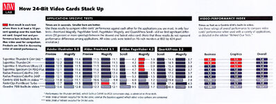

The trouble is that the full suite of benchmarks that exercise raw graphics functions, basic QuickDraw functions, and application oriented QuickDraw functions take *forever* to run, and due to discrepancies in available bit depths and resolutions everything needs to be run multiple times to capture the disjunctive comparable sets of results. Made worse still by the fact that back then it was very common for hardware to be optimized for specific use cases. Like a card could be great at 24-bit, but absolutely horrible at 8-bit just due to how the drivers and or hardware have been optimized.
Does anyone have any recommendations on what to limit things too? I was basically thinking 8-bit and 24-bit (where possible) at 640x480 and 1024x768 (where possible)?

Well I can predict the results;
  • On-board DRAM video - 100%
  • PDS VRAM HPV card - 140%
  • PDS A/V card - 70%
  • Nubus BUG PicklesXA - 35%
  • Nubus Supermac Thunder/24 w/ DSP upgrade - 30%

w/re those benchmarks: I predict that the PDS A/V card comes ahead of the onboard video, although perhaps not quite as much as the HPV card. The onboard video in x100 Macs isn't particularly fast compared to anything else at the time.
The reason Quadra video was so fast compared to NuBus graphics at the time (1992) was because it was on the '040 processor bus, but it did also have its own dedicated VRAM. The x100 video has that advantage but the onboard VRAM slots it down, plus NuBus video had gotten faster in terms of acceleration and having more VRAM. The PDS video card had both, I believe it had some hardware acceleration as well, so it'll be close to the top of those benches.
Entertainingly, the Mac 6200 outperforms the Mac 6100's built-in graphics on tests it can complete, because the 6200 has graphics with acceleration and its own VRAM on the '040 bus.
