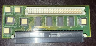

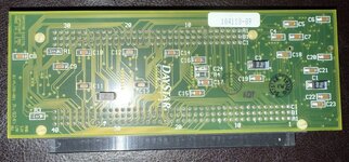

What is this Daystar card?
eraser
I think it's an LC PDS to IIci cache/accelerator adapter, based on casual searching. Can anyone confirm that? Any details?
That should allow use of a PowerCache 030 in LC/LCII.
