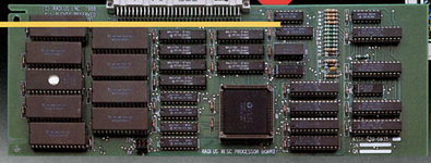

The Radius card should be a QuickColor if you can find those ROMs. But without the ARM processor it's not gonna go far.
The Radius card is either a QuickColor or QuickCAD, and it is only lacking the GALs and SRAM chips. the ARM is still in it's socket.

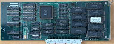

Only missing the single GAL22V10 at U27 now which wouldn't budge to my cracking attempts so far.

Ever seen the card Bolle has posted? 12MHz ARM CPU on a Nubus card. I wonder can you get them to do arbitrary code execution? Be good for a hardware backed Acorn Emulator on classic Macs if you can :)
I believe it is a QuickDraw accelerator? If I remember there are two versions with different ROMs for accelerating different things though... Truth be told I have a terrible memory.

I'm sure my memory is much worse! It's a 12MHz ARM2. It needs a MEMC chip to properly emulate an Archimedes, which it doesn't have. It looks like it's got a 256kBit ROM, which is 32kBytes (seems reasonable) and 256kBytes of video RAM.
Because it's written in 1988, it'll only support 8-bit Color QuickDraw. Maybe an Acorn Archimedes could be emulated directly if the ARM chip had access to the Mac's address space for that Nubus slot? Then the MMU on the Mac (even though it works in a totally different way) could provide a VM environment for the ARM? Though I suspect that's not possible either, because the NuBus slot will be on the wrong side of the MMU.
Let's assume it doesn't and the Mac has a second video card. Then we can use the video RAM as an ARM instruction/data cache and implement a JIT. The instruction set is fairly simple. ALU operations could be cached and executed as is. Branches to cached addresses would function as is. Some PC-relative loads would work. Load/Stores would have to be trapped with a SWI. The address part of a Load/Store is at least 16-bits, so that's a big look-up table.
Let's say most instructions operate at 12MHz, giving 6MIPs and Load/Stores at probably 15% of instructions take 50 cycles to emulate (vs 2 or 3 cycles on a real ARM). Then overall cycle time is (1/12)*.85+(50/12)*.15=0.696 or 1/0.696=1.437 MHz. OK, that's a pretty poor emulation speed compared with an actual Archimedes, but pretty good for emulation!
Looks like 64k of SRAM to me - and I don't think it would be used as VRAM because nothing would know to look there for the frame buffer. It would make more sense for the output from this card to be put in the video card's framebuffer, either by DRM / bus mastering, or by the host (hopefully the former).

Looks like it was clocked at 10MHz.
Weird. I thought that the clock input frequency on an ARM2 was twice the CPU frequency. However, they're right - a 10MHz VL86C010 can execute instructions at up to 10MIPs. The 6MIPs is only an average.
