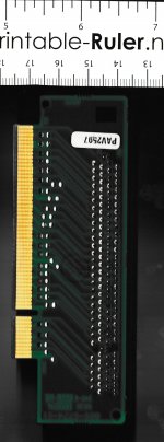

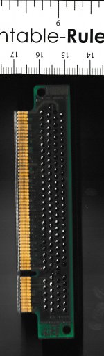

The "sideplane"  popped up in my window close enough to life size that holding the cardboard template I cobbled together about an inch and a quarter off the screen matches up almost perfectly. Even the CS2 cutout appears to be pretty close, I threw that on there roughly, expecting to be more than this little bit off!
Your pic of the solder side is probably good enough for a rough fit test with my mockup. There's just enough perspective distortion (leaning in building/keyhole type) in your shot to induce fudge factoring. An actual scan of the solder side of the PCI riser as I've illustrated above with the 6400 riser would give me hard numbers for the PCB design. As is, I can file the mockup down to a near perfect match for rough testing. Put the CS2 riser on the scanner at the same time and that will be another good reference for my workup.
Your top view pics cut off at the edges enough that I can't estimate the maximum PCI card length for the TAM. Could you measure the distance between the cover plate's metal shield and the sidewall/backside of the card area at the real of the slot? Looks to be at least a bit longer than a 7 inch card?
Thanks so much!
Time to start making a BETA version of the Dummy Two Slot Riser. The red outlines define the CS2 slot. Don't know why, but Apple spaced the CS2 PCB much farther from the PCI card's PCB than standard 2cm spacing. I thought the CS2 riser looked awfully tall for its purpose? It may have something to do with the curvature of the back a/o ventilation out the top of the fat back requiring more surface area or specific placement? Doesn't matter, good news is that the second slot might be added at standard spacing.
I plugged a standard USB cable into the connector protruding from a card's cover plate and measured a tad under 2cm as enough setback to bend the cable around 180 degrees without strain. So the second slot is the standard 2cm higher at a 2cm setback in reference to the standard TAM Slot in the light gray area representing the TAM's PCI riser.
Views are from solder side of the cards, matching scans above.
If the curve of the back is too tight toward the bottom (TOP of the upside down second card) inside the Fat Back, then I'll need to tighten up the slot spacing a bit to fit a higher profile card in the top slot, limiting the maximum height of components on the main card. But we're looking good so far! [:D]
Thanks again for the scans, evil one.
