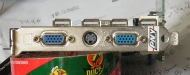

1) if someone would take dead-on pics of the SidePlane cover with a just a port cover plate installed so it's parallel to the straight side that would be great. I can use the plate for scaling a template in AI.
2) Real world measurements of same would be most helpful:
After playing around with Mini PCI overlays, I decided full blown PCI Slot might be within reach, so here's the second slot with a low profile MACALLY USB 1 card set back away from the backside of the SidePlane in the TAM. Given the component heights of Modem and CS2 NIC, I wouldn't be surprises to see a much higher profile PCI card tuck into the Fat Back. Sure a schiznit a full height short length card will fit into the low drawer of my 6360. The arched overhead the TAM's Fat Back is a gauntlet I can't let lie.
