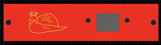

Some time ago, I designed a PCB backplate that will screw onto the expansion slot opening in the back of the SE, and take this extension lead:
Gerbers for this are available at https://github.com/cheesestraws/misc/tree/master/scuznet-mac-se-backplate. Do as you will with them.
