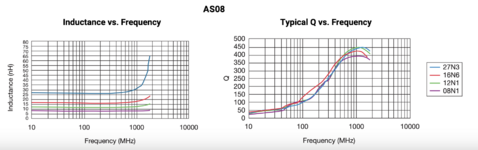

This is only true for ideal components, unfortunately: once you get into actual physical components, both capacitance and inductance are frequency-dependent, because physics is a mess and I'm amazed that people understand it in detail. This is why designing things that work at radio frequency is so painful. If you have a look, for example, at this datasheet (which is just a random RF inductor I pulled from google) you'll see it has a graph of inductance over frequency which shows really quite a large change over the designed parameter space of the inductor:

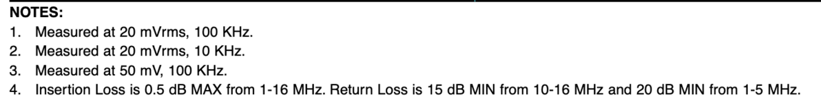

This is why decent LCR meters have a choice of frequencies to measure at: if you don't measure your inductor (or capacitor) at something like the frequency of the signal that's going through it, you won't get the same answer. And it's also why transformers and the like tend to specify at what frequency the measurements were made (unless they're basically single-purpose). The datasheet of the transformer that @tashtari linked to, for example, notes what measurement conditions - including frequencies - were used to reach the numbers it gives:

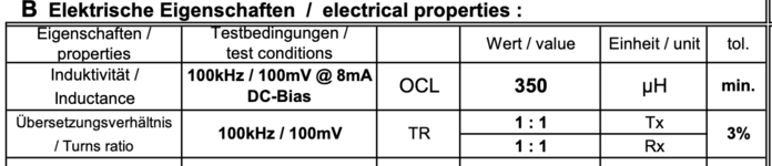

You'll see the same if, for example, you look at this datasheet for the first ethernet transformer that I found on RS:
The reason why I bring this up is not that I think in this case it matters, but because a serious specification for an inductive component should include it. This leads me to suspect that the chapter in IA is not really a specification, but more a 'here's what we built, have at it' kind of spec. Which leads me to believe, in turn, there's more wiggle room here than what the chapter appears to specify.
