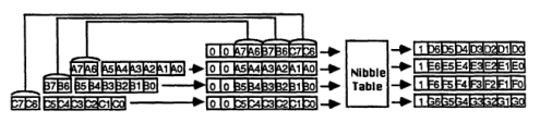

Reads still look doable. Start the SD card doing its thing while sending the address mark, it should have its data ready to clock out when it's time to send the data mark. Writes, though, are another story. Receiving the data coming out of the IWM takes 100% of the PIC's time, and once that's done, it needs to be decoded. Not only this, but it needs to be decoded twice: once to convert the 7-bit IWM bytes into 6-bit "nybbles" and assemble each quartet of them into three 8-bit bytes, and once to un-mangle the bytes from the brain-damaged checksum algorithm that GCR disks use, both computationally-intensive on a PIC. One can potentially do a little stalling for time while sending the address mark, but doing these things at the same time is just too much to ask. Maybe with a long enough unrolled loop it'd be possible, but that'd be a really big loop, and I've already halved my memory space with the active/inactive mainline.
