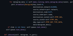

The RTMP broadcasts from netatalk's atalkd and the Fastpath 5 on Ethernet use a destination network of "0", so broadcasts are always to 0.255.
FYI, when using @finkmac's tap solution changing to destination_network=port.network in sending.py breaks functionality. This is with a newly pulled version from repo and a config file that works (other than a timeout on a Mac 512K) when destination_network=0x0000.

For RTMP broadcast packets, it appears that netatalk uses ATADDR_ANYNET, which appears to be whatever network the NIC is configured for. Ex: The router is at 6502.122, so RTMP packets are broadcast to 6502.255. I can test this after work with atalkd and my Fastpaths by setting up my EtherTalk network with a fairly large netrange.

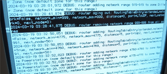

As soon as it starts, my LT devices can see both the local and remote (via AIR) zones, but only my LT devices are visible. Notably however, tashrouter immediately reports that its LToUDP network (999) is timing out.
Shoot. Okay, I'm working on something that will hopefully make everyone happy, please stand by...
Okay, so I added a separate broadcast method to Port and updated everything that sends broadcast datagrams to use it - this will allow LocalTalk broadcasts to use the short header and EtherTalk broadcasts to use network number zero.
Repo is updated, @mmjs can you pull it and see if things are working on your end, and @shirsch can you pull it and make sure I haven't broken you?
Is this still happening with the latest code?
