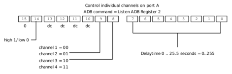

I was thinking maintain compatibility for the existing four outputs, but extending the protocol to recognise extra variations using the "don't care" bits in the ADB commands?
They wouldn't be "don't care" any more, an if you were using software written for the original you'd have to not connect anything to them because the behaviour wouldn't be predictable, but if I'm not being daft... it should be possible? To use them, you'd have to modify the original computer side libraries to send the extra bits.
Given bit 15 seems to be always 1, I think you'd only get 3 more outputs, instead of the 4 I hoped for. For "control individual channels" you could add an extra bit to the channel indication (bit 10) and it would work with 8 outputs, or even more if you used bits 10 through 13.

Actually, there are spare bits next to the channel select bits - you could potentially add an extra data bit there (instead of always 1, send a zero), and have that represent a second bank of outputs on Port A as a "virtual" box? There seem to be spare bits for send and read, next to the channel bits.
That wouldn't consume the jumper ids and would let you still chain devices.
I thought of repurposing the don't-cares, but I don't like what that'd do to compatibility with existing software. You wouldn't be able to add a third bit to the channel select bits in the form of Listen 2 where the MSB is 0 because you wouldn't be able to know what that bit would be in legacy software. Adding three more bits to the form of Listen 2 where the MSB is 1 would be harmless, but you'd lose the ability to change the I/Os with a timer, plus I don't know if every Mac-side implementation uses that form of Listen 2 to change the I/Os on port A. Using the multi-unit capability and compressing multiple units into one feels a lot safer and cleaner to me. Do you have an application in mind that would require so many I/Os that it'd need four chained devices with 12 I/Os each?
