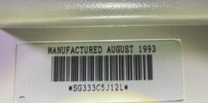

Hi everyone I picked up this Performa 475 and its strange to say the least. For starters it has a ROM slot, CUDA reset switch, and "PRIMUS" by the board serial number. This was made four months before the October release of these machines. I believe this was a machine Apple probably sent out to repair centers to familiarize themselves with the machines before public release. Also note the incredibly strange case. Pictures below, any ideas or information is greatly appreciated.

It's not a prototype. I've seen these before. Apple prototypes tend to use cases with no badging at all. The thing with Apple back then, they did a lot of strange things that didn't make a whole lot of sense to us now. There were LC 475s that used the LC III case, and ones that used the 475 style case.
At best, this is just an early production machine, hence why it would have a ROM slot so that a ROM card could be offered in case there was a bug/issue with the onboard ROMs. This is why they started putting ROM slots on machines in the first place. It's not common for machines to be manufactured several months before they were made available to the public. Apple's manufacturing and supply chains were quite a mess back then compared to how they operate now.
As for the CUDA switch, yep some 475s had these, I've seen a bunch with them.
PRIMUS was just the codename for the 475, it being included on the serial number doesn't mean it's a prototype.

My case is slightly bigger than a stock LC475, a weird thing to not is with the jumper usually it will ID as an LC475 or Performa 475 well with the jumper off it says it’s an LC475 (with the software I used) and with the jumper it’s a Quadra 605. Was this possibly what I said about maybe a unit to learn on?
That’s so strange I wonder why?
Why they offered the upgrade? So people with an earlier model could get a 475 without paying full price. Apple offered logicboard upgrades for a lot of machines back then.
Hmm? The case you've posted looks the same as ones I've had.
That's normal with the gestalt ID jumper. With it not there it's an 475 and with a jumper it identifies as a 605.
Nope. Apple did all sorts of weird things in this period. Using up older cases before transitioning to a newer design for the same model was one of them.
Edit: Also the only difference between the 475 and the earlier LCs was the logic board, everything else is interchangeable. Not really much to 'learn' on these.
I understand but still I’ve seen Only a couple of LC’s like this but never one with the Performa badging.
LCs were sold as Performas and Quadras. The LC II was also sold as the Performa 400, 405, 410 and 430. The LC III was Performa 450. The LC III+ was 460, 466, 467. They probably had this generic Performa badged one as an easy/cheap way to use up cases and just stick different labels on them. The only thing that distinguishes different LC models really is the logicboard.
