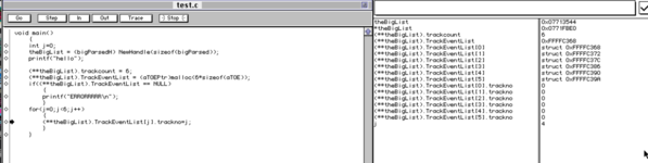

Problem: I can't seem to make internal assignments 'stick' for some reason. it has worked some times by stepping through with the debugger, sometimes stuff like theBigList.TrackEventList[j].trackno stays at 0 instead of taking values like 1,2,3,4,etc.

clear out the debugger expressions and retype them from scratch from the loop
This is the source of the faulty code stripped down to the bare minimum. I use Symantec C++ 6.0. I'm just adding the standard library of ANSI to get tried and true simple printf outputs to get sanity checks for this prototype. Or I use the debugger.

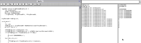

ok, the same example above, after running back in forth into my main project, rebooting my emulator, etc.
no.
longer.
works.

this should output 0,1,2,3 in the first 4 trackno debugging values on the right since I'm at index j=4 here.

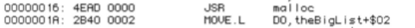

Add #include <stdlib.h> to bring in the correct prototype for malloc. Without that, the compiler assumes the return type is 2 bytes wide as show in the disassembly (Source -> Disassemble):
Note the MOVEA.W D0,A0 instruction which moves a word (16 bits/2 bytes) from D0, malloc's result register, to A0.
Here's the disassembly with stdlib.h:
Now the instruction is a MOVE.L D0,theBigList+$02, a long word move directly to theBigList's aTOE* member.

thanks all, it seems to work taking 0 chances with:
-using a MaxApplZone() at the start
-using MoreMasters() for good measure (who knows how some .midi files go up in size and data content)
-NewPtr and DisposePtr for those arrays in case a 2nd, 3rd, etc file is loaded up (so I'm currently moving away from malloc)
-HLock and HUnlock for the handle, although that turns out to be pretty small* and could be transformed into a Ptr itself.
*it's only gonna carry a few atomic members and an array of pointers to the other levels of my overall structure. in the worst case, about 20-30 pointers to add on top of that.
The only thing that is staying weird is that using a printf in conjuction with the debugger -- the values I was checking up in the debugger are now displaying the correct values, but printf-ing the same variables while the debugger is halted prints some 0's instead, as if there's a hold up on the character buffer used by printf. That must require some in-depth knowledge about Symantec THINK C that's above my pay grade.
