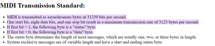

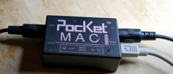

Wow guys, thanks for the high quality tutorial on variable types. I found very old documentation in which SerGetBuf uses ints instead of longs, maybe that was triggered the error for me. It's definitely a long in more recent documentation, including THINK Reference Viewer.
The bad formatter character for printf was a stupid mistake that I do occasionally.
The real mistake was not setting up the .AIn driver properly with the clock like I did for .AOut. There was no chance of getting anything other than garbage before this was done. Once this was fixed with the printf statement, I saw the buffer count slowly rise up to 1024 bytes, which was supremely satisfying because at that point, I had put back my own custom 1k input buffer handle, so I was witnessing saturation. Just leaving my keyboard controller idle makes these 0xFE stay alive midi bytes. I could push it up faster by mashing buttons.
Quickly after I got this behavior, I reacted to note on and off bytes (funelling them into a quick state machine hack to get all 3 bytes of both of these commands) and produced the last video above. In case you are against watching video results in a forum, here's a recap: it's showing my playing of the SQIII theme, which sends MIDI in bytes to my app, which then turns around and sends them to MIDI out to my MT-32. The 0xFE are simply read and ignored, but at least they're flushed out of the buffer.
