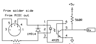

I assembled a small breaboard midi-in circuit, powered by a bench supply providing 5V, according to this well known circuit:
which looks like this (I had optoisolator H11 chips from previous projects)
and just to prove it works, I plugged my pocketmac midi out cable to this breadboard while cubase was playing a tune, and I checked an oscilloscope set to decode RS232*, 31250 bps, 1 stop bit and I was able to single shot capture a bunch of midi commands, here's a Note On set of three bytes on channel 9, but since its velocity is 00, it's probably interpreted as a Note Off:
(*I know the mac serial or midi isn't RS232, but it's the closest setting on my scope I can use, and you can modify it to oblivion with the other parameters anyway)

The circuit you posted describes both the sending and receiving device.
As the sender, you only need to worry about limiting current to the receiver's optoisolator.
The only component you need is the resistor at the bottom of the schematic. 4.7K is a safe starting value.
SE/30 modem port -> pocket Mac, midi out -> my breadboard midi in connector, current limited loop
Other side of H11: 5V and GND are provided and a 1k resistor acts as load that I'm probing.
I don't understand what you're suggesting I do differently since my use case under normal conditions from Cubase prove that I can detect MIDi bytes that make sense.
Ok, so the breadboard is the receiver. Measuring voltage directly from one of the Pocket Mac pins would also work.
If what @joevt posted is accurate, you can drive the SC-88 or other MIDI device directly from the Mac's serial port with just a resistor in between.
I didn't know if your goal was to keep the Pocket Mac or not.

C:
    int *addr = (int *) 0x0001DA;
    *addr = 11;
    asm { MOVE.B (SP),(SP) }
    *addr = 0x28;
this freezes my program but I still can move my mouse cursor around. When I click, even that freezes as well.
int is two bytes but the registers are 1 byte.
0x1d8 is defined as SCCRd in SysEqu.h or SysEqu.a or SysEqu.p
SCCWr is 0x1DC.
LowMem.h has macros for accessing those which look like this:
C:
#define LMGetSCCRd() (* (Ptr *) 0x01D8)
#define LMGetSCCWr() (* (Ptr *) 0x01DC)
You need to load the 4 byte pointer that is at 0x1DC, then add 2 to that to access aCtl.
C:
Ptr addr = *(Ptr*)0x1DC; // there's a pointer at 0x1DC - read it
addr[2] = 4; // WR4 = register pointer set to WR4
addr[2] = 0x84; // WR4 = X32, 1 stop bit, no parity
addr[2] = 11; // WR0 = register pointer set to WR11
addr[2] = 0x28; // WR11 = Rx and Tx clock from /TRxC Pin (HSKi on Macs)
I think one of the documents in the Apple document archive describes a control code for setting MIDI mode directly.
TN1018 seems to imply that the clock input from a MIDI device is 2 MHz which would require the X64 setting to get 31250 bps. In that case, WR4 should be set to 0xC4.
The tech note describes csCode 15 for initiating an externally clocked asynchronous 8N1 mode appropriate for MIDI. See if that Control code is available with the serial driver that you are using.
YES, it finally works.
Thanks for the refresher tips on bytes and on how to address pointer offsets more efficiently.
Thanks for your patience and offering great guidance and some good ol' vintage docs.
As soon as I saw the scope behave well with this under 31,250, I disconnected my breadboard and reconnected my Roland SC-88ST and this is a little demo I threw:
P.S.: I used x32 as per your previous suggestion, because that's what I use in Cubase when I go into MIDI settings and it seems to work just fine.
P.S.#2: I tried to use csCode 15, but I didn't go far because I have no documentation on what the bits mean at all.
TN1018 has all the info about csCode 15. It says csCode 15 takes a byte like csCode 16 does. For csCode 15, use value 0x80 for X32 mode as shown in Table 1. The bits appear to match the upper 2 bits of WR4.
I wonder if you could use SerReset to set baud constant to 57, use csCode 15 to set x1 mode, then use csCode 16 to use baud rate generator with internal clock. This might enable a 31077 - 31240 bps output mode without requiring an external clock.
